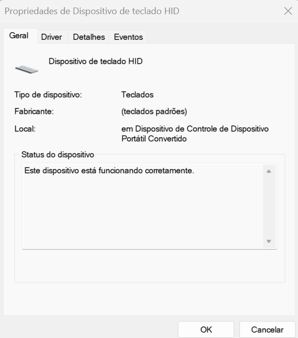

If you right click the driver for keyboard HID and select properties, what does it show in the General tab?

The properties dialogs of each of those instances say that the drivers are operating normally.
That would lead me to suspect the fault is with the keyboard.
Does the keyboard not work while it is connected?
