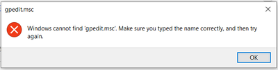

2) Also tried the steps at the bottom of your response but failing at step 2 (in blue) below.
"Also, try the steps recommended below.
Step 1. Use the Windows shortcut keysWin + R to launch the Run.
Step 2. Type “gpedit.msc” and then hit the Enter.
Getting the error message below:
Please help asap. Appreciate it much in advance!
