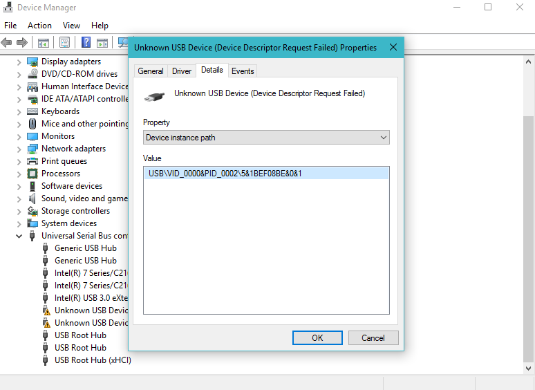

Tried that but it was not successful. :Crying:
Here's the details:
  1. USB\VID_0000&PID_0002\5&1BEF08BE&0&1:USB1.PNG5&1BEF08BE&0&1.PNG
  2. USB\VID_0000&PID_0002\5&1BEF08BE&0&2:USB2.PNG5&1BEF08BE&0&2.PNG
  3. Regedit after rebooting:USB registry.PNG
Any further suggestions?
Thanks.
Sanil.
