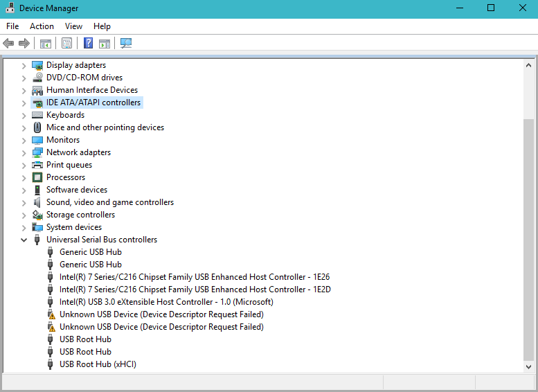

Can any help with this problem? Have a Pavilion G6 with no USB 3.0 as I am aware.
USB (3 ports) not working.However, when the plugged the mobile, the mobile does get charged.
Device Manager shows "Unknown USB Device (Device Descriptor Request Failed)".
Running Windows 10 64 bit. Tried everything like uninstalling, updating etc as the information on the internet. Also, updated the drivers using Driver Easy but still getting the error.
Any suggests, please?

Hi
The laptop has been installed with clean installation of Windows 10. Therefore, there is no recovery point.
When disabling the "Intel(R) USB 3.0 eXtensible Host Controller - 1.0 (Microsoft)" the "Unknown USB Device (Device Descriptor Request Failed" disappears but placing USB, the USB is not found.
In addition, updating "Intel(R) USB 3.0 eXtensible Host Controller - 1.0 (Microsoft)" the following are given:
Selecting "USB xHCI Complaint Host Controller" the same issue but shows the "Intel(R) USB 3.0 eXtensible Host Controller - 1.0 (Microsoft)" on device manager. Selecting "Chipset Controller" installing the Chipset Controller on the device manager but the propery shows that "No drivers are installed for this device" .  But "Unknown USB Device (Device Descriptor Request Failed" disappears but placing USB, the USB is not found.
Totally confused on what is going on!!!??????
Any suggestions, please?
