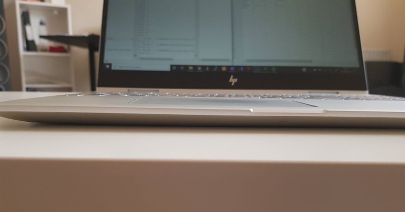

Last night I was a really annoyed when the mouse started again to slowly creep to the top left of the screen and starting to search the web I came across a topic from this forum (this one). Looking at the laptop from profile I saw that the left side or the trackpad is elevated. Overall I suspect the battery is swollen and affecting the track pad also.
Thinking about the battery... it makes sense, for a long time now the laptop was shutting down at 20-25% battery, and I mean straight hard shutdown, not sleep nor hibernate, I assumed it was an Windows setting and ignored it. This is a bit annoying considering that I have kept this laptop on a desk for all it's live and only disconnected the charger to perform a battery cycle once per week.
Battery usage shows 137/1000 cycles. I've used the battery recall app and it shows that there is no recall planned for this product.
What would you advise I should do? I would like to avoid a thermal incident with the laptop.

    Thanks for your help. I have yet to be re-contacted by the HP team. In the mean time I've decided to have a look at the battery and eventually took it out for safety. Now the mouse stopped random movements and I can close the lid of the laptop without resting the screen on the edge of the keyboard.  Image below shows the bloated battery.
    Looking around forums I found out that Windows 10 keeps track of the charging capabilities of the battery over time. So I ran the Battery report on my machine.
    I was not impressed... . Windows keeps track of the Current and Design Capacity of the battery. However on my machine the design capacity was dropping with time, making the potential charge capacity show as 100%. Nice! keep in mind that the laptop shuts down without any warning at 30-40% battery capacity... . I find this to be very sneaky on behalf of HP.
