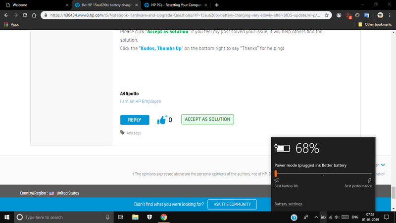

hello @A4Apollo, my problem with charging still persists. Now it has got worse. After a certain limit my battery isint charging anymore. I have tried all the methods that you  have asked me to follow. I am attaching a screenshot. Please do check it and provide me a solution.
My laptop is in this 68% since last 3 hours.  I hope to get a solution asap.
