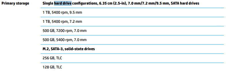

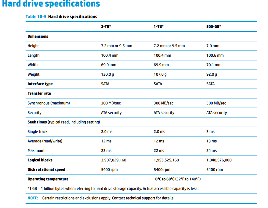

The HP 255 G7’s “301 error” means the system has detected a failing drive, the SSD. Replacing the SSD with a compatible model (M.2 SATA ) will fix the issue, but you should back up your data immediately before the drive fails completely.
Before Proceeding further I would request you to perform the below step and go through the link shared.
Run HP diagnostics on startup
  • Power on or restart your notebook.
  • As soon as the HP logo appears, press the Esc key repeatedly (about once per second).
  • A Startup Menu will appear.
  • Press F2 to open System Diagnostics.
  • In the menu, choose Component Tests → Storage.
  • Select : Extensive Test
  • Run the Test.
https://support.hp.com/us-en/document/ish_3894112-3198952-16 Follow the link for detailed steps.
https://kaas.hpcloud.hp.com/pdf-public/pdf_13033529_en-US-1.pdf Service Guide.
