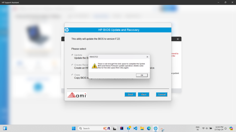

I am attempting to update the BIOS on my Victus Gaming Laptop 15-fb0147AX (8F503PA) using the HP Support Assistant. The update process consistently fails with the error message "There is not enough free disk space to complete the System BIOS and Device Firmware update operation. Delete some files to free disk space then retry again."

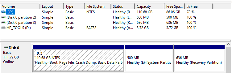

s shown in the attached screenshot of my Disk Management, my C: drive has over 50GB of free space (specifically 52.09 GB), which should be more than enough for a BIOS update. I have tried the following troubleshooting steps without success:

However, there's another confusing aspect to this issue: When I run the HP PC Hardware Diagnostics through the HP Support Assistant and check for BIOS updates, it reports that my BIOS is up to date. Yet, my system currently has BIOS version F.21 installed, and I know that versions F.22 or F.23 are available (but I cannot install them). Furthermore, the HP Support Assistant itself still prompts me to update the BIOS, indicating that it recognizes an available update.
Could you please provide guidance on how to resolve this issue and successfully update my BIOS without resorting to a USB drive, and explain the discrepancy in the BIOS update detection on my Victus Gaming Laptop 15-fb0147AX (8F503PA)?

Take a look at an older thread that I answered with a member who was having the same problem. YOu are going to have to increase the size of the EFI partition.
Yours is 100MB it needs to be around 250MB.

I created a 500 MB EFI system partition (ESP) on my old notebook years ago thinking of installing a different OS just for fun that stores its bootloader in the same ESP, so I needed a larger partition. But I haven't installed the new OS to this day.😃
Anyway, I created a new 500 MB ESP (see the screenshot below) and deleted the original 100 MB ESP using the diskpart command in the Windows Recovery Environment (Win RE) launched via a bootable Windows installation usb drive.
Microsoft heavily protects the ESP, and you cannot delete it within the Windows. You have to do it in Win RE.
Personally, I don't think the risk of BIOS corruption with deleting the existing ESP is any higher than the BIOS corruption risk with a BIOS update. Just my opinion. . .
If you ever want to delete the ESP in command prompt, let me know and I'll provide instructions.
