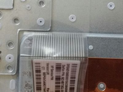

So, bit of an update with pictures.
This is the back of the keyboard unit showing the second fold in the cable and how the cable looks slightly pinched where it meets the edge of the metal brace:
The issue is exacerbated as this is under the left-hand palm rest. As you use the keyboard you're pressing the edge of the metal brace into the ribbon cable...
This is my fix. You can see the two black lines on the cable where the original folds were, with the new fold just below the grey electrical tape (I've moved the barcode sticker off the ribbon cable). Just to point out, I didn't make a second fold in the cable, just let the cable find it's own way.
So far, working fine.
