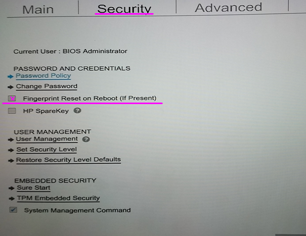

(1) Access BIOS Setup Utility using a series of key presses during the boot process.
  • Turn off the computer and wait five seconds.
  • Turn on the computer, and then immediately press the esc key repeatedly until the Startup Menu opens.
  • Press F10 to open the BIOS Setup Utility.
BIOS > Security: Check option [x] Fingerprint Reset on Reboot
( Text may differ slightly with different bios versions )
BIOS - Security - FingerprintBIOS - Security - Fingerprint
(2) Save BIOS settings and exit.
(3) Test if fingerprint <reset> was successful
(4) Please report your results
Hi Ub6424, thank you for the suggestion!
I enabled the sensor reset but unfortunately there was no impact.  Hello still gives the same message. (I also shut down couple of times just to be sure..)
And yes I have installed from HP support center among others also the latest BIOS update.
So good ideas are further on very welcome.
