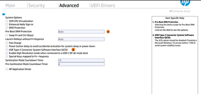

you hust need to enable in bios
This can be performed by pressing the F10 key while the computer is restarting.
  1. Select Advanced > System Options.
  2. Check Enable High Resolution mode when connected to a USB-C DP a lot mode dock.
