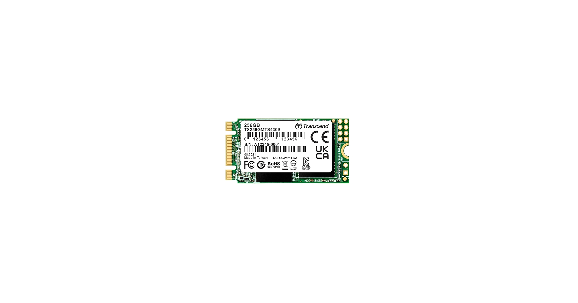

This is a type that will fit in my laptop:
https://www.conrad.nl/p/transcend-ts240gmts420s-sata-m2-ssd-2242-harde-schijf-240-gb-mts420s-retail-...
Hi David,
Thank you for the info. This is the ssd i am looking for. Installing an OS on this drive will be possible?
So do you recommend to switch my OS (Win10) from 2.5 inch ssd to m2 and will it be faster? I think it is easier to use my 2,5 inch disk for storaging files and use a seperate ssd for OS.
