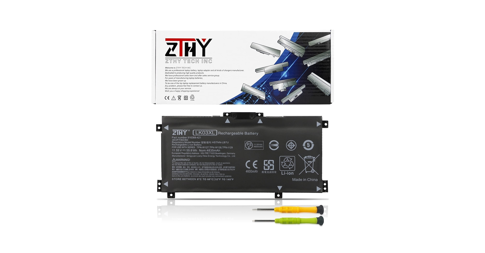

HP no longer has it in stock. This is a "compatible" 3rd party battery but rated 5 stars on amazon.com. It would work fine for you.
Post back if you want me to try to track down a genuine HP battery and please accept as solution if this is the info you needed.

I believe your machine uses same 3-cell, 52-WHr, 4.55-AHr, Li-ion battery part # L09281-855 which is N/A from HP
https://partsurfer.hp.com/Search.aspx?searchText=L09281-855
Please try
https://www.newegg.com/p/16J-0010-01X41
