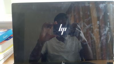

  • Today, as I was working on some documents, my screen started tearing. a line would show up in the middle of the screen, shifting the top half of the screen to the left a bit. the line then moved up to the top of my screen repeatedly, after a few seconds of this, my screen went back to normal. Not sure what it was, I continued to type for a few more minutes, then it came back. but it continually got more and more distorted as it continued. colors started to shift too. I took a video and a picture of it happening, then it stopped shortly after. my screen went back to normal. but then the process restarted again after a few minutes. it became a process
before I turned my computer off again, I installed the recommended graphics and bios drivers from HP's website to try and fix it. after the software install restarted my computer, everything seemed fine for a half hour. but then the screen flickering and distortion came back.
I went into the BIOS to see if the screen flickering was there, but nothing happened there. it only happened after I turned on windows and started moving my mouse.
I've sent a support tixket to HP support, but I'm not sure what type of problem this is. my laptop is brand new and It hasn't left my desk at home unless I pick it up to use in tablet mode. I don't necessarily think it needs a screen repair, because ths screen is fine in the bios and when starting up but something is definitely wrong with the entire laptop.
 this is what the distortion looks like on startup, but it goes away when I go to the login screen here:
