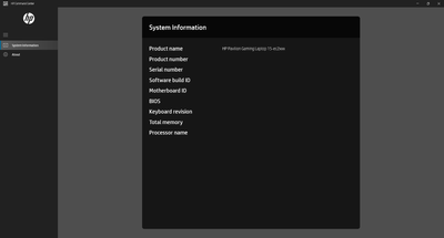

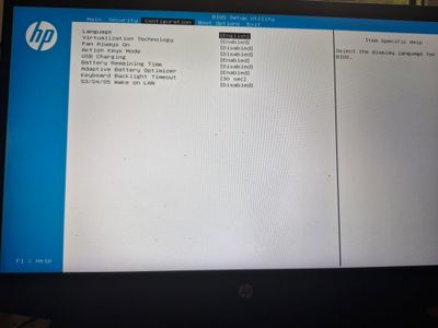

I have tried everything on the list and here's what happened. (Pictures below)
1.) msconfig configuration only shows up to 6, which only holds it to 6 logical processors when I check task manager.
2.) My bios is currently at Revision F.29. I cannot find the advanced CPU settings, or the CPPC setting to enable.
3.) I downloaded HP Command Center. It either crashes upon opening or is stuck analyzing my laptop.
4.) My laptop is already on High Performance mode, and I just reconfirmed it.
5.) I also noticed that when I ran my laptop on linux it would show all 6 cores and 12 threads, but running on windows only allows for 3 cores and 6 threads. I wonder if it is a windows related issue?
@npyla5891,
OK, your findings strongly suggest that this is a Windows-related issue rather than a hardware failure. Here’s what I’d suggest next:
Key Observations & Next Steps:
  1. msconfig Limitation
    • As expected, msconfig isn’t actually unlocking cores but rather capping them. Never mind: you should leave it unchecked to allow Windows to manage CPU allocation dynamically.
  2. BIOS Limitations
    • Since you cannot access advanced CPU settings in BIOS, HP may have locked these options. However, your CPU is fully recognized in Linux, meaning the issue is not BIOS-related but likely Windows misconfiguration or corruption.
  3. HP Command Center Crashing
    • This suggests a possible software corruption. It’s not critical for solving the issue, but you could uninstall it completely, restart, and reinstall from the Microsoft Store.
  4. Linux Shows Full Core Count, Windows Does Not
    • This is the most important clue. If Linux detects all 6 cores / 12 threads but Windows only sees 3 cores / 6 threads, then Windows is likely the issue.
