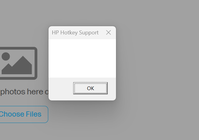

This is my problem. when i was type f3 or f4 key then this problem show my screen. plz help me
Hi F3-F4. If you already tried the solution on page 8, perhaps you do not have the fn key on your keyboard lit up. Try this:
1. Hold down the fn lock key. On my HP Studio Zbook x360 G5, this means I have to hold down the left shift key.
2. At the same time, press the fn key.
3. When these 2 keys are held down together, the fn key has a small light that becomes illuminated and stays on. Now when I press the illuminated fn key and the f3 key together, the screen brightness decreases. When I press the illuminated fn key and the f4 key together, the screen brightness increases.
