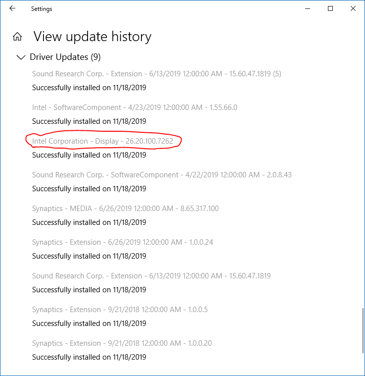

I did a bit more digging, and it appears that the HP Site, HPIA, and even Softpaq Download manager all believe that the latest driver installer is:26.20.100.6911
However, it appears that Windows 10 Update installed version  26.20.100.7262 before I ran MPIA.
MPIA says that HP's catalog (Reference Image) has an older version of the drivers. Both are DCH drivers apparently, but somthing is out of whack here. SDM considers the graphics drivers as Not Installed. but not critical.
It is my understanding that, in order for a driver to be installed automatically by Windows Update, the OEM needs to have certified it for a given hardware ID or something to that effect. So, I am confused as to why HP would have given the green light to Windows Update for the 7262 package but do not have it on their own website as the latest for the Z2 G4 workstations.
I am not exactly sure at which round of windows updates the newer 7262 drivers were installed, but I would have to say it was probably after the 1903 feature update, which started installing before I could even get past the OOBE setup and to the desktop to pause feature updates.
This likely means that every machine I deploy now which comes from an 1809 build (all 26 of them)  is going to do the same thing.  On the next machine I start on, I am going to do the OOBE setup with the network cable disconnected and take a look around. And I will get the HP BIOS update in as HP support had suggested to me when I called for guidance on whether to use HPIA or SDM and what order to do Windows / HP updates.   I was told, get the bios update in, then run windows update, let it install any feature updates and don't bother installing HP driver softpaqs before then because Windows will probably remove them and replace them with drivers IT ithinks are better. Run HPIA after all the MS updates are in to put the right OEM drivef packages in.  This is what I have done.
I read that you cannot roll back the new Intel Graphics DCH drivers to the legacy packaged versions that include the Graphics Control Panel in the installer. As you can see from the dialog box below, I don't have the option to roll back. That means that I never got a chance to install the HP DCH driver package.
What is also puzzling is:  I thought that all the DCH intel graphics driver packages use the Graphics Command Center and not the Graphics Control Panel, The Command Center has to be separately pulled down from Microsoft Store. So I am puzzled as to why the softpaq for 6911 DCH  says Intel Driver and Control Panel...
Anyway, I don't have a fully warm and fuzzy feeling about this, but I have to deploy the workstations to the end users anyway. hopefully I or we can make some sense of what is going on.
