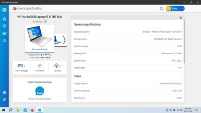

 Further Progress:
 A surprise for me, no Boot Manager needed at all. Using an Adapter to Key change the WIFI M.2, the SSD took the Install/Initial Reboot/Set Up with out the need for a Boot Manager.
C: Drive (Via Adapter in WIFI M.2) showing in HP Support Assistant:
