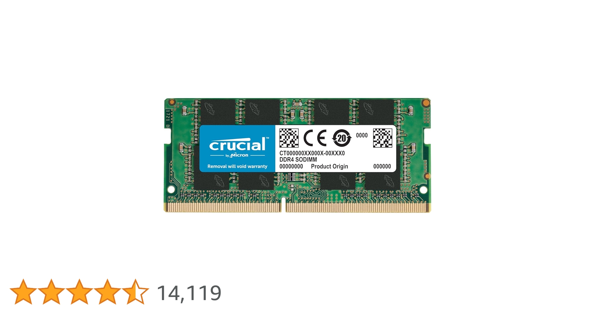

Just a quick question about memory upgrades.
I have a HP Notebook - 15-bs158sa with 4Gb of RAM.  I belive that I can upgrade to 16Gb and was looking for 2x 8Gb compatible DDR4, but it's mighty expensive, if you can find it!
I'm hoping to substitute with some Crucial memory instead and found these 2 options on Amazon -
https://www.amazon.co.uk/Crucial-CT8G4SFS824A-PC4-19200-SODIMM-260-Pin/dp/B01BIWKP58/ref=pd_lpo_sbs_...
https://www.amazon.co.uk/Crucial-CT8G4SFD824A-PC4-19200-SODIMM-260-Pin/dp/B019FREJOQ/ref=pd_lpo_sbs_...
It's been a while since I did anything with hardware and I'm after an opinion on which would be better or if there is a third option?
Many thanks in advance.
Mark
Hi Mark,
Your notebook officially supports 16GB of DDR4 2400Mhz (2x8GB).
This is what the system has been tested with, however HP DDR4 systems will actually run with 32GB of RAM (2x16GB), so that would be the actual max.
Now there are two slots and you can use your preferred brand such as Crucial, Samsung .... So the two links you posted will work (one is dual rank and one single rank and will make no difference), You can also see on Crucial page which guarantees its upgrades:

Thanks for all your help David, only took 10 mins and the SSD slot is present, so that’s my next upgrade.
