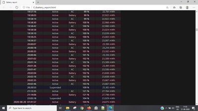

1. When I charge the battery , after reaching 55 or 60% , it stops, and starts after few seconds. Thus the process goes on and on till it is 100% charged or I switch off the charging. One thing to note is - At 60% ,it stops charging and charges again till 61% and then turn off charging - again - 62% and turn off.
I have attached the battery history , kindly see the weirdness as it shows battery charged till 121%.
Issue while chargingIssue while charging
Goes till 121%Goes till 121%

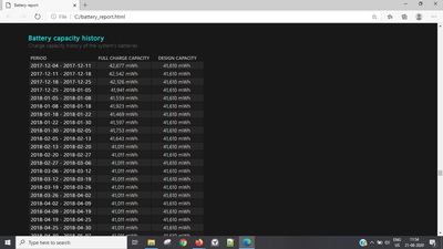

Charge capacityCharge capacity
After 2 yrsAfter 2 yrs
