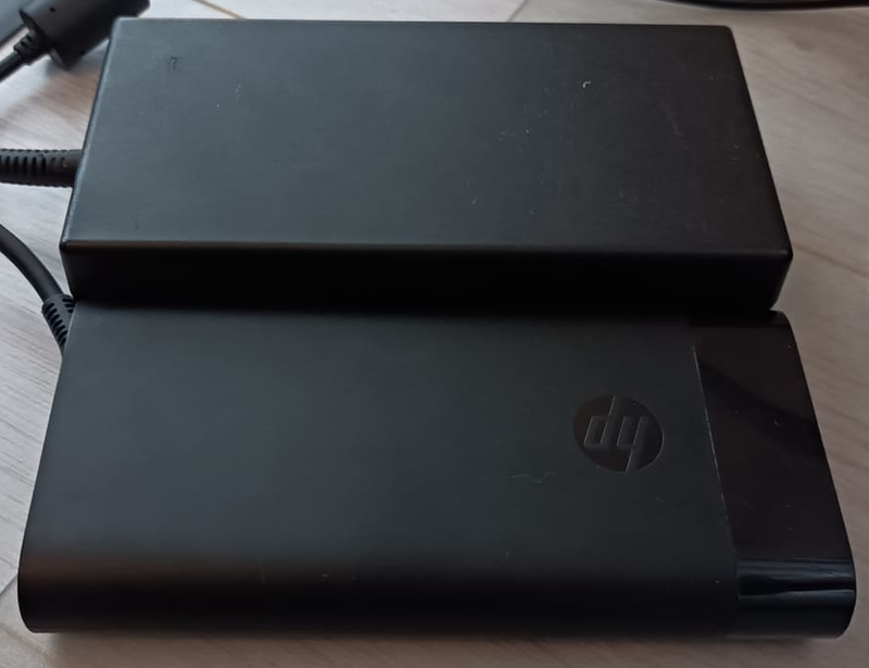

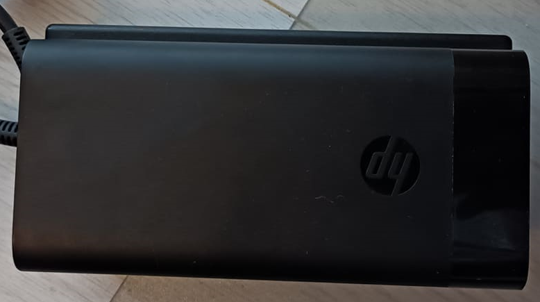

First things first, here is the comparison of HP's 200W PSU vs an aftermarket one. These two bricks are rated for the same Wattage while the HP one is about half the other's volume. Seeing this makes the overheating issue less of a surprise.
200W brick comparison 1200W brick comparison 1200W brick comparison 2200W brick comparison 2
In the OP I inquired about a 330W OMEN PSU that HP has now stopped selling online. Despite HP's only feedback being "We haven't tested this PSU with this laptop", I can say that the 330W PSU works ... sorta. It charges the laptop fine, however, when gaming the laptop throttles itself back and forth between lowest and highest CPU clock speeds. This because the laptop recognizes the charger as non-standard through its dedicated ID channel. The mechanism behind this throttling uses artificial overheating signals, which can be circumvented on either a software or hardware level:
Spoiler
200W bricks comparison 1200W bricks comparison 1200W bricks comparison 2200W bricks comparison 2200W brick comparison 1200W brick comparison 1200W brick comparison 2200W brick comparison 2
Spoiler
