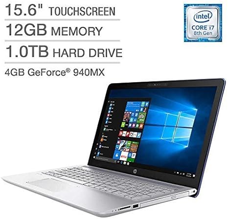

I purchased an HP Pavilion 15-cc183cl (see image and specs) and I would like to know if the laptop's M.2 slot has the M.2 mounting screw already in it, or do I have to buy one separately to install an NVME PCIE internal SSD?
I would love to upgrade the computer with a Samsung 970 Evo Plus M.2 NVMe SSD but I'm not sure if I need to get a mounting screw for it to work or if it's included in the laptop. If so, which screw should I get? Where should I buy it? Does any screw work, or only specific ones with HP computers?
Thank you in advance!
