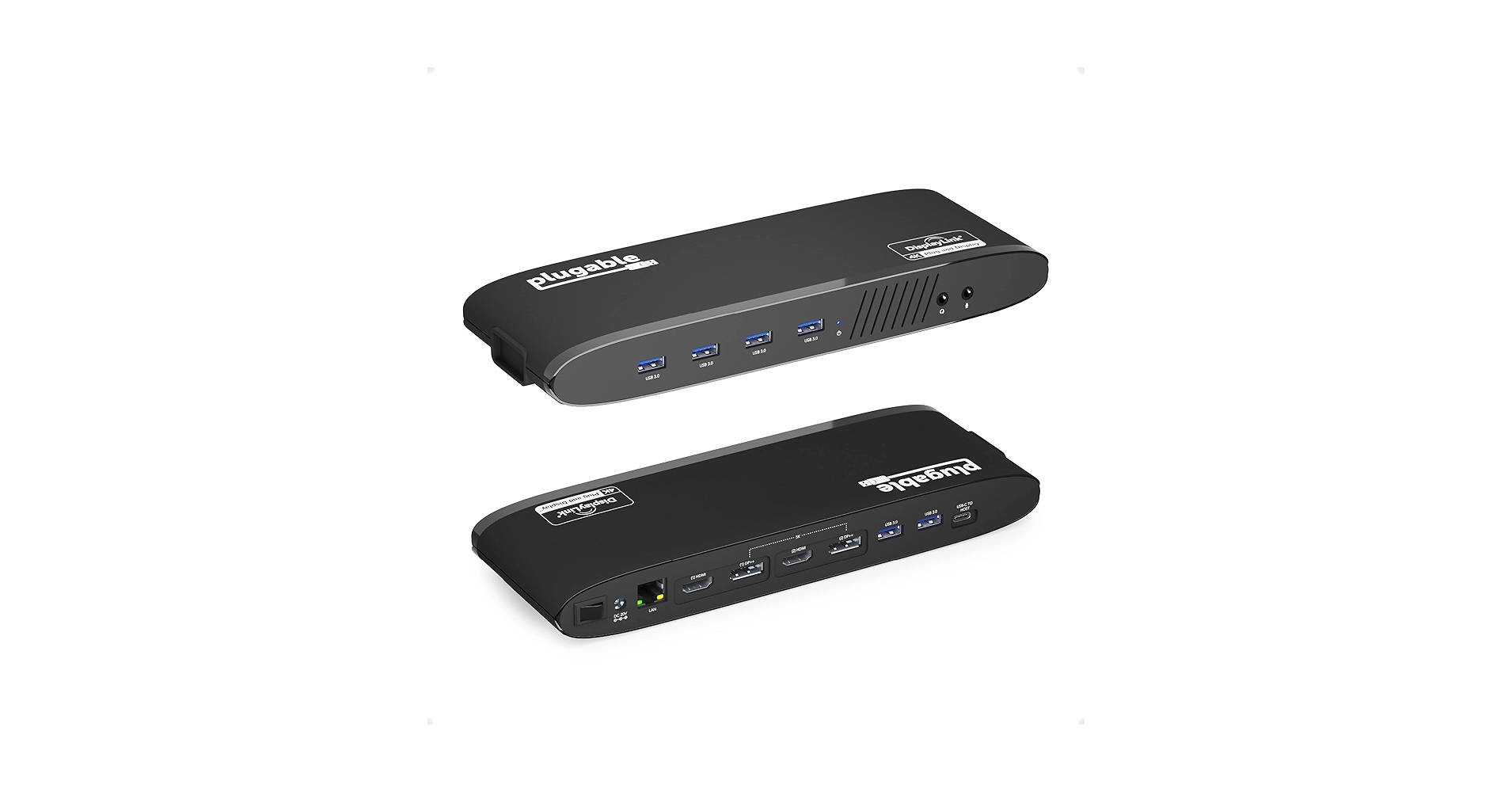

Hello All,
OK after a bit of research I found a solution.
I installed the Displaylink drivers then I purchased the following Dock:
https://www.amazon.com/gp/product/B07CRSH25X/ref=ppx_yo_dt_b_asin_title_o01_s00?ie=UTF8&psc=1
Once I did this the system worked great. I now have a dual monitor setup:
Thanks for all your help & tips on how to fix this issue.
