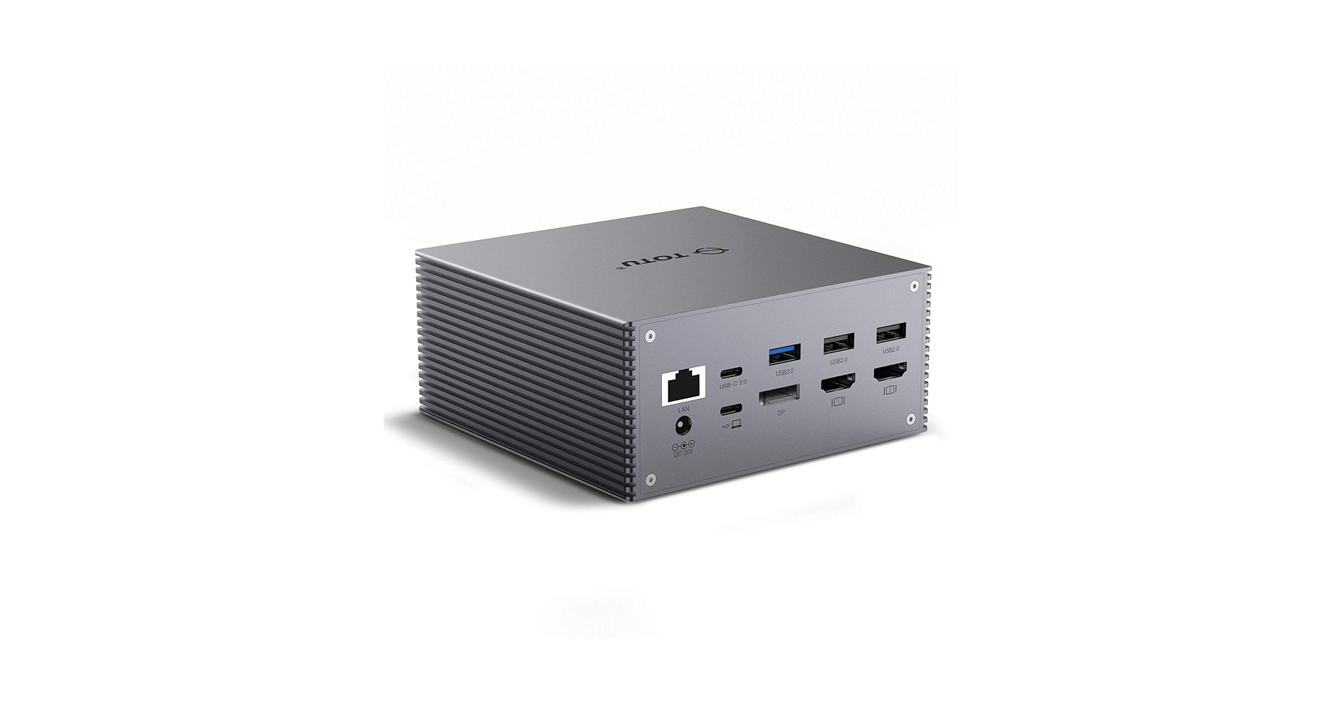

Hello All,
I have been trying to get my laptop setup with a docking station for dual displays. I thought the USB C 3.1 port would be fine to simply order a USB Docking station. I guess I was wrong...
I ordered this Docking Station: https://www.amazon.com/gp/product/B07Z53139N/ref=ppx_yo_dt_b_asin_title_o01_s00?ie=UTF8&psc=1
But when I connect the displays to the HDMI ports on the Dock and then connect the dock to my laptop the displays are not detected.
I have seen other folks ask similar questions and I have seen the link to the Plugable Docking Station. Before I send back the one I already have I just want to make sure 2 things:
1) Can I get the one I already have to work?
2) Will the Plugable Docking Station truly work with the HP Pavilion?
I have to say I am a little disappointed at how difficult it has been to find a docking solution.
Thanks in advance for any help.
Also, I will update this thread with my solution.
Thanks,
Dave
Solved! Go to Solution.
01-27-2020 02:39 PM
Hello All,
OK after a bit of research I found a solution.
I installed the Displaylink drivers then I purchased the following Dock:
https://www.amazon.com/gp/product/B07CRSH25X/ref=ppx_yo_dt_b_asin_title_o01_s00?ie=UTF8&psc=1
Once I did this the system worked great. I now have a dual monitor setup:
Thanks for all your help & tips on how to fix this issue.

01-27-2020 02:39 PM
Hello All,
