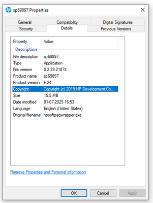

  • Found and downloaded the F.24A BIOS from HP’s SoftPaq archive: sp69897.exe
             https://ftp.hp.com/pub/softpaq/sp69501-70000/sp69897.exe
  • Verified compatibility by confirming the board ID (1970) via hex editor.
  • Created a FAT32-formatted USB flash drive using HP’s BIOS utility.

  • Downloaded the BIOS ( File name: sp69897.exe(15.6 MB) ) as suggested by you.
  • Created a USB recovery drive using the file.

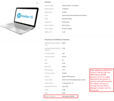

Hello @banhien – You're correct that the main processor in my PC is an Intel Core i5, and I'm not experiencing any problems with it. The issue lies specifically with the AMD graphics processor 8670M.
I’d like to briefly summarize the problem once again.
  • I’m using an HP Pavilion 15-E039TX Notebook PC, which originally came with an AMD Radeon HD 8670M (2GB) graphics processor as listed in the product specs (Please See the product specifications screenshot)
  • After updating the BIOS from version F.24A to F.28, the AMD GPU is no longer detected in Device Manager. specs (Please See the Current Sate Device manager screenshot)
  • Only the integrated Intel(R) HD Graphics 4000 shows up in Device Manager.
  • Additionally, the AMD Radeon 8670M card is overheating even while idle—an issue that was not present before the BIOS update.
  • When the system was running on BIOS version F.24A, the discrete AMD GPU was detected and functioning normally.
Given that these problems began after updating the BIOS, I would like to downgrade back to BIOS version F.24A. If a rollback is possible for this model, I kindly request guidance on the correct and safe method to perform the downgrade.
Thank you in advance for your support and expertise.
Below are the screenshots for your reference.
1.Product Specifications screenshot
2.Current State Device Manager Screenshot
