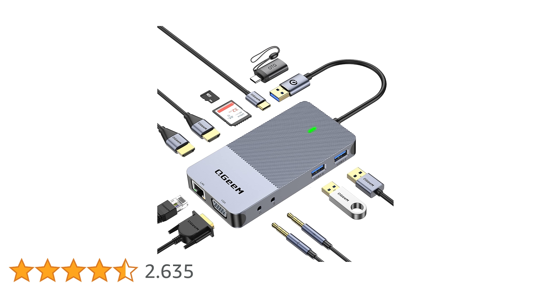

11-18-2021 01:20 PM
Thank you very much for your answer!
Just to make sure, https://www.amazon.es/-/pt/dp/B07WYD88M6/ref=psdc_937788031_t2_B08R9WZKFN like this would then work, am I correct?
11-18-2021 01:52 PM
Did I say you can't Connect to an external monitor with / without hub/dock/adapter to its USB-C port ?
Regards.
11-18-2021 03:31 PM
Thank you once again for your answer!
I can connect to an external monitor if I use the HDMI port directly from the computer.
If I use a hub that is connected through the USB-C port and then I connect to the HDMI the hub has, it doesn't work.
I wanted to check if I use a hub that is connected through the USB port (not the USB-C) and then connect to the HDMI the hub has if it will work. The ones I shared in the previous post are some examples I found and I would like to know if then it would work.
Thank you again!

11-18-2021 04:02 PM
Your USB-C port has no video signal going out. No legacy USB port like the one circled in green has native video signal coming out of it. However, there are certain devices which are DisplayLink certified. There is a chip inside these devices which creates a video signal on a usb connection so you can attach a monitor and it will have a picture generated by the computer. These can be either legacy USB or USB-C. These are not simple hubs or adapters but tend to be larger and more expensive devices. Just search amazon or eBay and look for "DisplayLink USB Dock". DisplayLink just works with Windows 7 and above; the driver is built into the OS.
11-18-2021 05:16 PM
You still did not read my first reply which says
>>>> If I get another hub from the USB port will I be able to have it with HDMI support?
Yes, you can use USB - HDMI adapter or hub which is DisplayLink Certified to use more external monitor(s)
