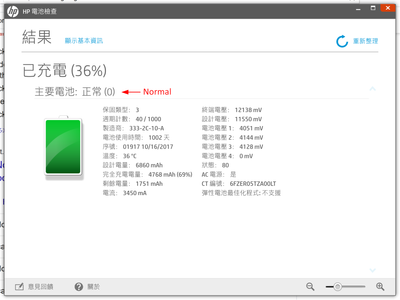

1. HP Support Assistant
 - First, I examined the battery with HP Support Assistant, but it shows "normal" after the diagnosis as follows.
The battery is still being locked and cannot be charged even though it is able to discharge, so now my laptop is powered up by the AC adapter only.

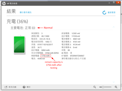

However, I noticed that the battery can still be subtly charged when doing the diagnosis with HP Support Assistant!
1. Remain capacity showed "1751 mAh" before testing with HP Support Assistant as follows.
2. Remain capacity showed "1756 mAh" after testing with HP Support Assistant. The remain capacity increased from 1751 mAh to 1756 mAh, showing it was subtly charged.
This result implies the battery can still be charged with this bug although the battery is damaged physically, in this case of blown fuse here! That is dangerous and with the risk of explosion or burning of the battery!
