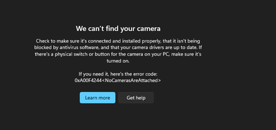

hp true vision hd webcan not working

I see you are experiencing issues with the HP Laptop Truevision HD Camera not working.
To use your webcam, simply slide the privacy camera switch on/off on the right side of your HP Notebook PC or press the webcam shutter key.
Open Device Manager. Navigate to Imaging devices. If there is no imaging device, then no camera modem is configured or there may be a camera hardware failure. Then right-click Imaging devices and select Scan for hardware change.
Try the steps recommended below and check if it helps.
1. Open “Settings -> Privacy -> Camera.”
2. At the top, look for “Camera access for this device is on.”
3. If it is off, click the “Change” button and turn it on.
4. Under that, check for “Allow apps to access your camera” and make sure it is On.
5. Next, look at “Choose which apps can access your camera.” Make sure apps you want to use with your camera are enabled.
6. Re-enable the device.
Try reinstalling the Webcam driver from Device Manager
Select the Start button, type Device Manager, and select it from the list of results.
Look for Camera or Imaging Device and expand the List
Look for Camera driver then right-click it, and select Update Driver.
Select Search automatically for updated driver software.
If these steps don't work, try reinstalling the driver: Open Device Manager, right-click the Camera driver, and select Uninstall. Restart your PC and Windows will attempt to reinstall the driver.
If the issue still persists then you can try Reset PC and Keep my files from windows to resolve the issue.
Also, try running the hardware diagnostics test on your PC and check if the webcam on your PC is functioning correctly.
