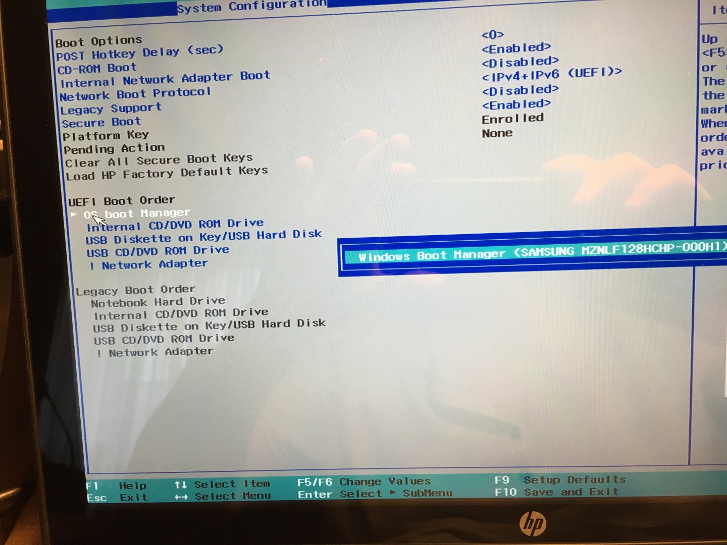

this is a picture from the bios wher you see the original samsung ssd M.2 installed.IMG_1027 (Large).JPG

I grasp that you have replaced the Samsung MZNLF 128 HC HP-000H1 type M.2.  as it is almost full and you require more space. You are replacing it with a Samsung 850 EVO-SSD M.2 500GB but it is not recognized in the bios. When I checked the HP Pavilion Gaming Notebook Maintenance and Service Guide, I noted that it is not a recommended replacement. This simply means that it has not been tested and the outcome is unknown. With the new drive installed, if you go into the bios and select setup defaults (F9) it will scan for any hardware changes. Does it find the new 850?

Yes with the drive installed I push the f9 button in the bios but nothing changed. No new hardware detected. I return already to the shop with the Samsung Evo 850. I ordered another make: adata Premier Pro SP900 (ASP900NS38-256GM-C): says 3. I hope it will recognize this one. How do I peruse this tread to @erico?

Both of the replacement M.2 SSDs were the wrong SSD type.
You bought MLC spec M.2 SSD in both cases. The A-Data and the Samsung were MLC tpyes.
 The original Samsung M.2 SSD in your notebook was a special type designated NVMe, which at the moment happens to be one of the fastest SSDs on the planet.
The  original disk yours had has the very same specification that is installed in the desktop I am typing this on and also what is in my HP Product loan Spectre 13.
That is why the BIOS did not recognize the M.2 SSD disks you put in to replace the original.
