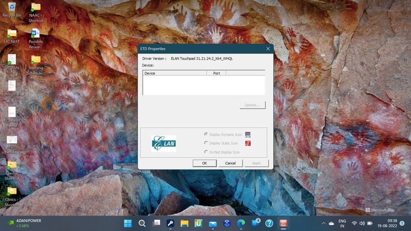

The Synaptics/Elan software for the touchpad has an option to turn off itself when <external USB mouse> is connected.
--->>>Please disable option !
the whole ETD has been greyed out... since the issue. that was the first thing i checked.
