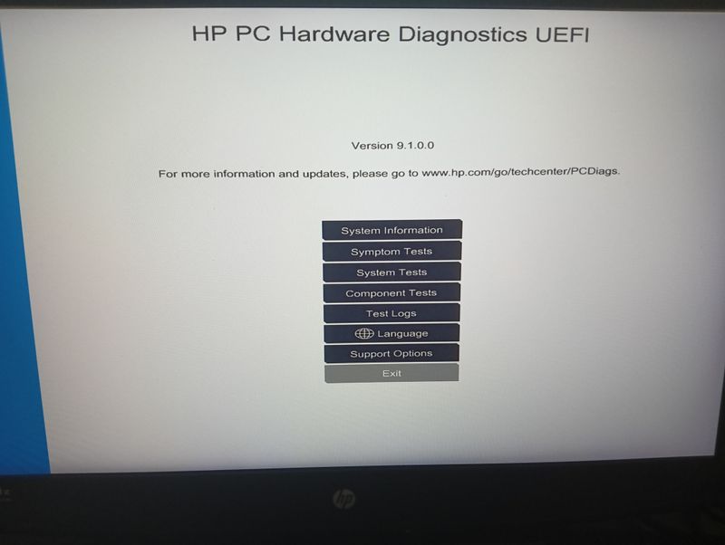

Where can I find the "Firmware Management" section? I have HP PC Hardware Diagnostics 9.1.0.0. I did not change the hard drives installed at the factory.
Three disks are displayed in Windows Explorer, external HDDs and flash drives were not connected.

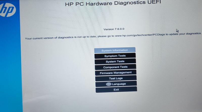

HP drivers download site for your model lists Hardware Diagnostics UEFI ver 7.6.0.0. I have the same version on my laptop. See the screenshot below. It has Firmware Management. It appears that your Diag. UEFI has been recently updated to the latest version, and somehow, it's missing Firmware Management. I don't know how to fix it.
