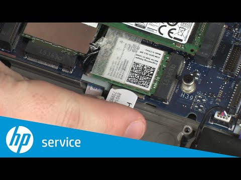

08-15-2024 08:03 PM
That should be the same as shown on the following Clip
https://www.youtube.com/watch?v=CIqfa4Dtr1o

08-16-2024 09:37 AM - edited 08-16-2024 10:39 AM
Thanks. Unfortunately, the system board on the G3 is different to the one on my G5. On my G5, the SIM enclosure appears to be on the underside of the system board when the base cover is removed (i.e. the side closest to the keyboard). I think I can only access it by removing the system board. I guess that's why HP put a slot on the top cover ... and then sealed it up again. 🙄
Regards,
DannyB07
