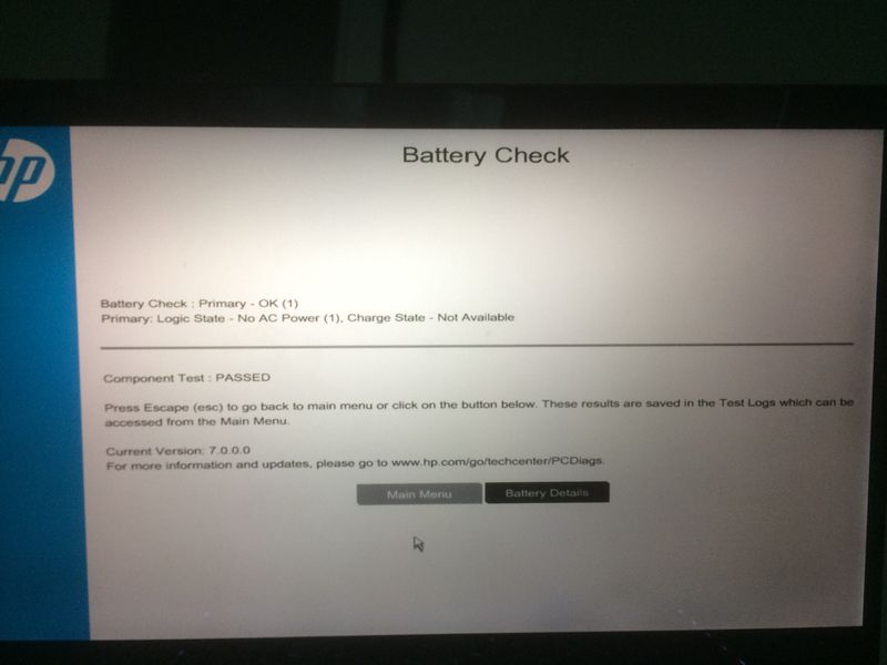

I've gone through the above mentioned step, and attached are pictures of the test results. When I am performing the battery test without the AC adapter connected, it passses successfully; on the contrary when I connect the AC adapter and perform the same test, a failed result occurs.
From what I understand it is my AC Adapter that is not OK, but I would love to get an expert translation of the test results though. I should also add this about the AC Adapter and PC:
  •  The AC Adapter came along with the PC which I purchased a little over a month ago. It was doing great until it stopped and the connected not charging problem started. I assume a month is less time for such a device to fail.
  •  The AC Adapter charges the PC when the PC is powered off or is in sleep mode, so I somehow do not understand why the test says that the AC Adapter is not OK, yet in some form it provides power to the PC. I also tried it with another computer, and it was doing OK, but not just on this one.
What should be the next move going forward from here? Also, about the battery calibration thing, when does it occur? Coz I cannot say that for a new PC the battery is lasting enough (only for around 3hours, which is not enough in my opinion).
Thanks

@GedeonKas
As you've performed relevant troubleshooting steps and the test failed, I would request you to contact our Support and our Support Engineers should be able to check the available service options for your laptop.
