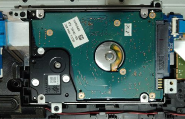

Do you have an HDD like this?
You can get an adapter like this
BUT YOU NEED SATA-3 LIKE BELOW OR IT WONT WORK IN YOUR LAPTOP
as it is not compatible with M.2 NVMe or AHCI PCI-Express SSDs
Get this instead
