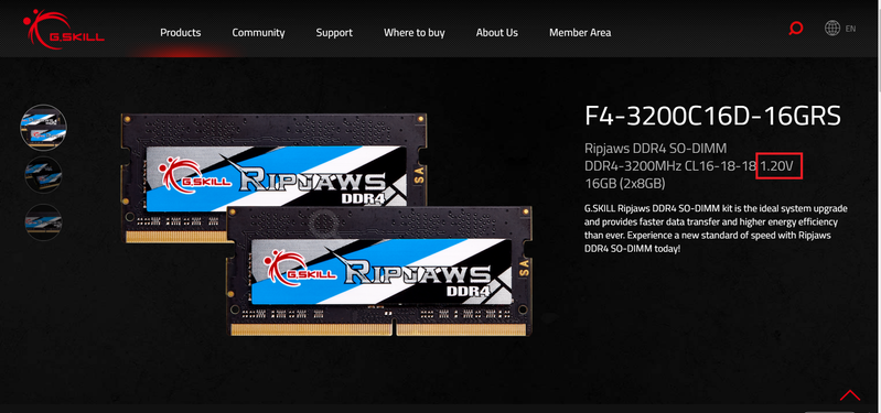

I want to upgrade my main laptop memory 2 x 8Gb SAMSUNG K4AAG165WA-BCWE 3200Mhz DDR4 SODIMM  DDR4 memory modules with 24-22-22-52 timings to a better option from G-SKILL
(the upgrade it will be done on a HP authorized license service center here in Greece, I will not do something to my own) with timmings 16-18-18-43.
the G-SKILL memory kit is also rated 3200Mhz DDR4 SO-DIMM 2 x 8Gb  F4-3200C16D-16GRS
https://www.gskill.com/specification/2/197/1540866230/F4-3200C16D-16GRS-Specification
It is possible to run with the laptop ?

The only way to be not able to run I assume is the memory voltage 1.2 VS 1.35 Volt.
On my modules says 1.20V , on Crucial says on some modules 1.20 and on premium ones 1.35V (there clarify an exta 150mV power)
On G-SKILL ones advertise 1.20V
So your answer is not 100% guarantee as correct.

You see on the page for the RAM you want to use
You do not have this option in BIOS. So the RAM will run at default value. Probably 2666MHz
The RAM in the machine
no XMP and input clock 1600MHz (DDR 3200MHz)
The Ballistic RAM by Crucial also require XMP and will not work.
