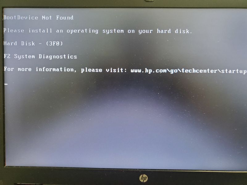

I used RUFUS to create the Bootable USB but the result was the same, I'm attaching a picture of the error.

The hard disk error indicates that the BIOS firmware sees the disk as having problems.
No EFI file and the image you provided show me that the Windows 10 installation was not successful.
