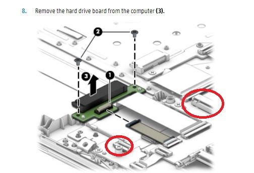

Your laptop has a 1 TB 5400 RPM hard drive so that fills up the hard drive bay. There is an option on your model to install an M.2 in a caddy that replaces the hard drive in the same bay. However, right next to the hard drive is a dedicated M.2 slot to add an M.2 2280 form factor SATA SSD IN ADDITION TO the hard drive.
M.2 slot and mounting screw circled in redM.2 slot and mounting screw circled in red
In the picture above you see the hard drive is off the page to the left. There should be a mounting screw for the M.2 provided but I cannot be sure of that. There is some chance unfortunately that HP did not have the motherboard made with the M.2 slot I show in the picture. Best to open up the machine before buying anything.
