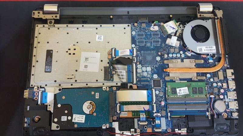

I had been informed that i can add an SSD M.2 to my laptop, by an HP SUpport Agent. He confirmed that my HP 15-bw032wm laptop has an M.2 Slot and provided me with link http://h10032.www1.hp.com/ctg/Manual/c05493256.  As of what i understand from the HP SUpport Agent and from the manual that the product is a Dual storage configurable (up to 256 GB Value SSD + 1 TB HDD).
I oredered SSD M.2 and i finally recieved it. However, i followed each steps in Maintenance and Service Guide but i could not found anywhere The M.2 Slot.

Here is what is in the Manual:
M.2 slot in blue rectangleM.2 slot in blue rectangle
Now look at your picture. See the rectangular tracing above the white cables running over to the hard drive? That is where the M.2 slot is soldered on models where HP chooses to actually put it on the motherboard at the factory. If you go back and look at past posts in the Forum however, we Experts who have seen a thing or 2 know that the Manual is the starting place. Many HP models in the model line that is "supposed" to have an M.2 slot in fact do not. This seems to occur quite often with WalMart models such as yours and also Costco models. Why? I will let you guess as I do not really know and I would be speculating.

Any Suggestions on how to fix the problem. and can i replace the HDD With SSD 2.5, if so what is the components i need?

Look I have told you what you can do. Yours is a WalMart model as the model number ends in wm. Some resellers buy Walmart models and sell them on amazon.com. No way for you to know that but Walmart models are often "defeatured" so WalMart can sell them cheaper.
There is nothing to fix. Your laptop is what it is can't be modified and I linked you to the 2 products you can buy and install. The 2.5 inch SSD will mount where the hard drive is using the same hardware and the hard drive can be placed in the DVD adapter I linked you to. Happy to provide more step by step instructions but I don't want to debate blame or fault here as I have nothing to do with it.
My Apology  for getting into this matter, as i was shocked. Anyways, i would like you to elaborate more upon the steps required and the hardware needed so that i can have both SSD (for the Operating System) and HDD (as extra storage).
