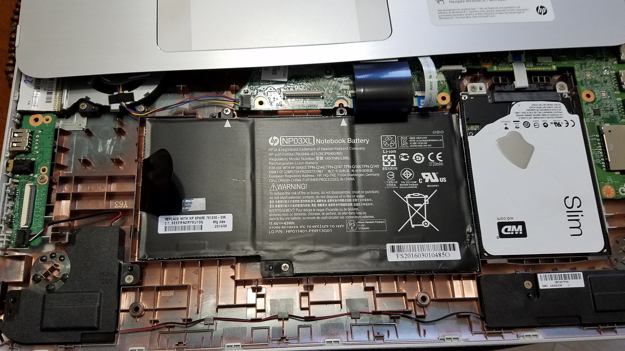

04-13-2016 08:55 AM
Just replaced the internal battery, which was expensive and a huge pain in the ***. Don't miss the two screws hidden under the back rubber cushions, and the other two hidden under sharp thin plastic case-colored stickers.
Sorry to say that it does turn orange for a short while, but then I'm still receiving the flashing white LED by the charging port, and my Envy tells me there's no battery installed (even though it will actually RUN ON BATTERY for a few minutes).
This is obviously a design flaw and defect. We've had several customers who are angry at us because we cannot fix it. I suspect HP cannot fix this either - something is obviously ary with the charging circuitry. As a matter of fact, this computer never held a charge from day one. We'd leave it sleep for a day, fully charged, and come back to find it shut down completely. Should have submitted a warranty claim then.
