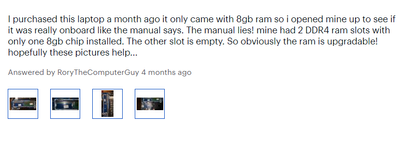

^ I stumbled upon Rory's post whilst looking for answers & there is two slots! so I guess I'm going to check anyway before I order something (thanks for the links, btw). But I'm pretty sure now it will, in fact, be upgradeable. I was also in the manual earlier and that was the point at which I threw my hands up in the air and came here, haha

I'm glad you found that post which seems to confirm that chapter 5 is correct.

Someone on this forum took one apart and found the memory was indeed upgradable.
