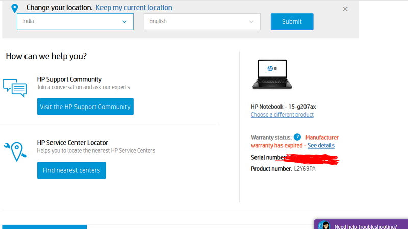

here's what I got upon selecting my country:
I found two service center that are in my neighbour city. both of them have a "(Onsite)" tag on them. So Will I have to visit any one of them (most probably) or will I be able to get the service at my home (possibly) ?
@amosthecoolboy
I have sent you a private message with the required details. kindly check your inbox.
