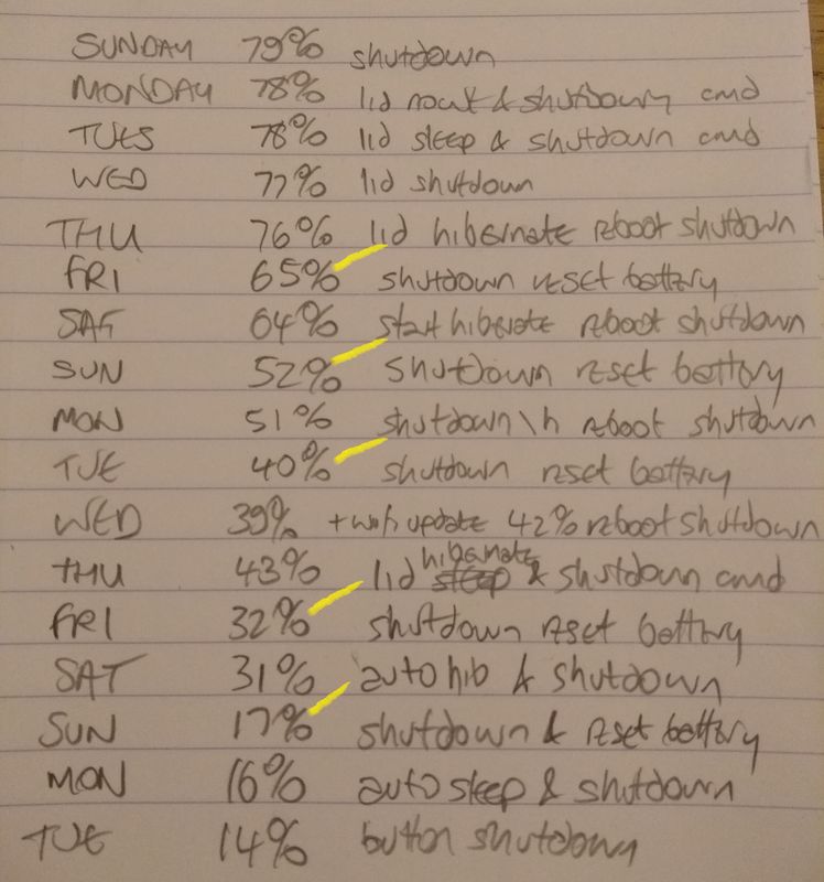

Hi @Echo_Lake, thanks for responding.  Answers to the above:
  • I don't think it occurred after a windows or software update.
  • No, but it's not the charger and the battery charges fine when on mains power.
  • No, the laptop is fine running on battery.
  • No, there are no errors.
I appreciate you asked a standard set of questions, but it's fairly clear that the battery draining fault is not caused by the battery or charger.  I'm on the second laptop, second charger, third battery and third motherboard.
The battery draining fault only happens after the first time the laptop is hibernated (until I remove the battery).  If I don't hibernate, I don't get the battery draining fault with subsequent shutdowns (or hibernates).
The link you included describes how to access and remove the battery, and this is what I did to "reset" the laptop when the battery draining fault occurred during my testing, as described in my original post. The points in the rest of your post were done when I originally raised this issue with the second laptop, and showed that the hardware and battery were fine, and BIOS was up to date.
See the above notes over the days I conducted the tests.  The left column is the day of the week, the middle is the battery charge level observed when restarting the laptop on that day, and the right is the action I performed on that day after restarting.
Each day I did one "action" and nothing else, as described in my original post, followed immediately by a restart and shutdown.  The yellow lines link a hibernate action on one day to the observed battery charge level ~24 hours later.  As you can see, each time the action was some form of hibernate, followed by a restart and shutdown, the following day the battery charge was ~10% lower.  The "reset battery" notes refers to temporarily removing the battery for a short time.
If I do not reset the battery, the battery charge drops ~10% each day of shutdown until the battery is flat.

I appreciate your efforts to try and resolve the issue. I would suggest performing system factory reset will put the computer back to the original factory settings in this way all corrupted and outdated software will be removed.

Hi @Echo_Lake, thanks for the links.  I used the cloud recovery tool to do a factory reset.  On an immediate plus point, it successfully reinstated the windows store, needed to install an hvec codec, and which failed to reinstall when doing a standard reset.
I then repeated 2 of my tests to investigate the hibernate-battery-drain-state fault, first after performing a factory reset while keeping the laptop off wifi, and second after connecting to wifi and allowing windows to completely update. I wanted to see if a windows update caused or solved the fault, or made no difference.
In both cases, the 2 tests were:
  1. powershell "shutdown /s /t 0" to shutdown
  2. powershell "shutdown /h" to hibernate, immediately restart and immediately "shutdown /s /t 0"
As before, I waited 24h, rebooted and noted the battery level.  For the cases where the battery had drained after hibernate, I also temporarily removed the battery to reset it.
As you can see below, after the factory reset both before windows update (sat to mon) and after windows update (mon to wed), the hibernate-battery-drain-state fault still exists:
After a hibernation, immediately followed by a restart and shutdown, the battery drains ~%10 over the following 24h, regardless of whether windows had updated or not.
I've reported this to support and after going through the usual updating to the latest BIOS, driver, etc, without fixing the fault, the latest response is that losing 10% of battery per day while shutdown is "fine".
Even when the fault is only triggered by a brief hibernate.
Even when it's the equivalent charge of a mobile phone battery lost while turned off.
