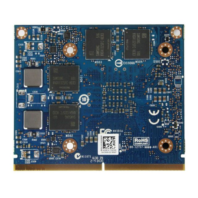

  • I want to try amd fierpro w7170m OR It is possible to show me the higher categories of graphics card available for my zbook  15 g3
This is what I have in mine. nVidia M2000M:
M2000M MXM video cardM2000M MXM video card
Firepro W5170M you have now:
W5170MW5170M
W7170M
W7170MW7170M
The W7170M is larger and likely will not fit.

If you go from an AMD card to nVidia you need a different heatsink. M2000M is a bit more powerful than the AMD card you have now:
https://technical.city/en/video/Quadro-M2000M-vs-FirePro-W5170M
