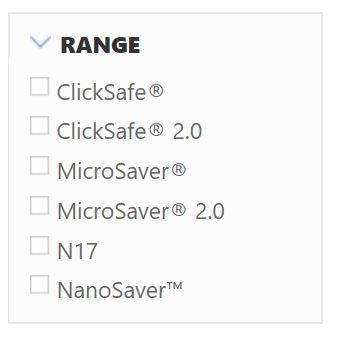

So I went out to Kensington's website to see if I could find a "MiniSaver" sercurity lock
As you can see there is nothing for a MiniSaver.  I called Kensington and they have no knowledge of a MiniSaver size lock.  So do I go with a MicroSaver, MicroSaver 2.0, or NanoSaver (N17 seems to be used with Dell laptops)?  Sure seems like HP doesn't seem to care about helping customers and providing appropriate details for their products.  The result of workforce reductions?
A laptop compatible with a Kensington MiniSaver (which is a model of lock) has a regular Kensington Lock slot. That means any Kensington lock other than a NanoSaver (which uses the Nano slot) or N17 variant (which uses the Noble slot found on modern Dells) should fit the slot. However, the mention of a MiniSaver might mean that the surroundings of the slot limit the space available for a lock body.

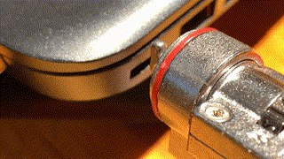

Ordered from Amazon, pictures show it in locked and unlocked positions and video shows it sliding in and out while in locked position.
These are my old locks.  Hard to tell with the 1 with the yellow ring but obvious with the red ring 1 that once I insert, I can only turn it 45 deg.  It has to go 90 deg to be able to lock.
So regular locks don't fit and can't turn 90 deg and the Nano is too small for the slot.
