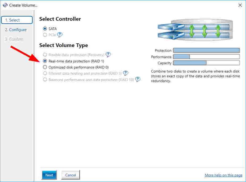

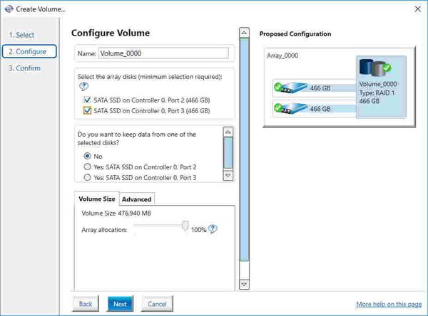

The specifications does show RAID support.  See the below image. You are going to need two SATA m.2 SSDs. Look at the storage controllers. It's "plural" meaning that there should be more than one m.2 SSD slot.  Backup your data and be sure to create the external HP recovery media before you do anything. Go to the Control Panel and then click on the Intel Rapid Storage Technology application. The first open panel should show you the available SATA devices. Then click on Create. You will have to make a decision between RAID 0 (more storage and better performance but no backup) or RAID 1 (replicate).  SSDs are quite reliable so I personally would choose RAID 0 The IRST help panels are quite good.  Good luck.  Sorry about the image quality as my program was set to 10% quality. My bad.

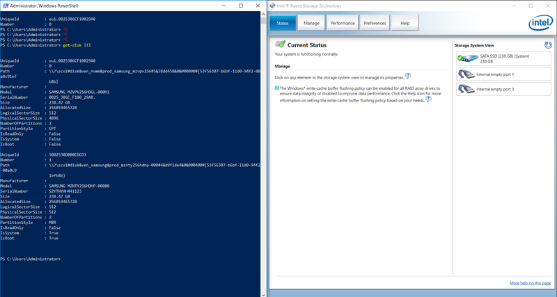

Thanksissue.PNG for your quick answer. Intel R.T does not recognize my second disk. You can check the image below. Do you have any suggestion?
Hi,
Based on your posted IRST information, I only see one SSD being discovered.

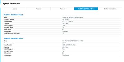

You can find my diagnotacis report below.
Also I added Intel Rapid Storage Tech report below. It did not recognize my pcie ssd.  I understand G3 Studio not supported non- Sata Rapid.

I suggest that you run the diagnostics at boot up using F2 key.  Under System Information --> Hard Drive Information you should see something like the below image.  Look at the Type for each HDD.
