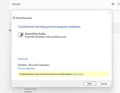

Check the System-> Sound settings in  Windows 11
If you don't see any options, type recording audio troubleshooter in the search box  and click on the Next in the troubleshooter that appears.  Let us know what the test results are.
Looking at "Input" it shows "Choose a device for speaking or recording". Then is shows "No input devices found"!
