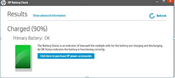

  • Also, performed a battery check using HP Support Assistant and Battery status is OK. Figure3.JPG
