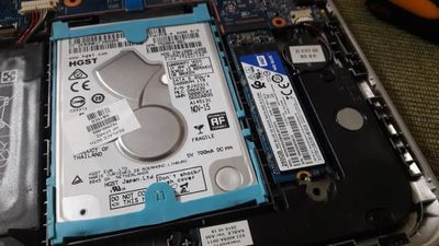

The place of the m.2 slot is on the right side of the HDD
I even tried WD SSD dashboard and keep saying no WD SSD detected
ssd slotssd slot

This what it looks after I inserted before!
HP has never really provided an explanation but we have had more than a few reports just like this and the only logical answer is the port is just not enabled in the BIOS or in the way the motherboard was manufactured. BIOS updates will not help as you have seen.
