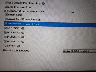

Check in the BIOS to see if the SATA port is disabled.
Sata port is enabled  
