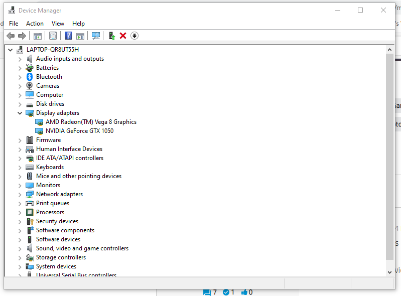

if it doesnt work, type device manager in windows search bar, open it, the go to display adapter, screenshot it. i will try to fix it.

I can see the video card in device manager, but I have the same message in my bios, bios doesn't detect it

its not that your bios doesnt detect. its that your reading the "proccesor type:     AMD Ryzen 5 3550h with Radeon VEGA mobile Gfx "
if you want to see the dedicated card its on the advanced tab, which hp locked so that you cant overclock.
